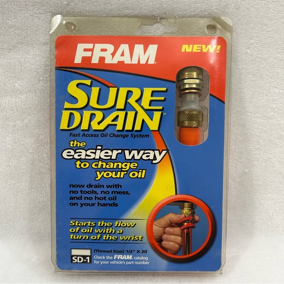

                I used them on my Caprice daily drivers for years. I thought not threading and unthreading the drain plug would be an advantage. As former police cars ground clearnce was not an issue, even on the one I lowered. After two of those cars reached 300K miles the valves went to the junk yard with the rusty cars. On the replacementt Caprice i use a product from Fram (the only useful product from that company) that has a brass cap and an internal valve that is pressed open by a wire on the hose It is simpler than it sounds. The product replaces the drain plug, and is much more compact than the Fumoto valve.. See below.
                Shop ryan55wills's closet or find the perfect look from millions of stylists. Fast shipping and buyer protection. FRAM SD-1 Sure Drain SureDrain No Tool Oil Drain change Thread Size 1/2 x 20. Brand New in the package never opened. Please see all photos for details
